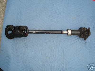

eBay Bravada Front Drive Shaft All Wheel! Never Used
Up for bids is a new Front Drive Shaft for a 96 Oldsmobile Bravada. I bought this drive shaft new for $1200. Before I was able to install in my Bravada I sold the vehicle. So my loss is your gain on this drive shaft.

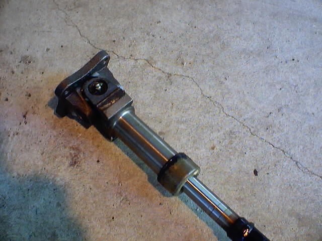

I remember a few years ago trying to find some info on getting any stock-ish propshaft from anywhere. This looks pretty similar to ours, minus the can joint up front. Anyone tried one of these or know for sure if a '96 Bravada shaft will or won't work in our setup? It looks quite a bit like mine, after having the front replaced with a U-joint.
The biggest difference I see is the rear mount is a ring, whereas ours is more of an X.
I wouldn't pay the $1,200 he says he did (which matches up with what I've seen for propshafts from the dealer). I probably wouldn't even pay the $300 he's asking for it (when Gilberts are only a little more). But if this does work, it may give some others some more options when trying to get a stock replacement.

Don't see any reason, minus a flange/yoke replacement, why it woulnd't work. chassis, front drive line, and engine/trans placement are all the same, unless it's a newer one with the 4l60 the length may be slightly different, but if it's an older brav, it should work.

You need to measure the inside diameter of the front part. The NAPA 4x4 replacement guys said worked great, didn't work for crap when I tried it. The 4x4 part had a smaller internal diameter on the front end and basically wouldn't fit on the front flange correctly.

True, but the bravada is AWD, and the early ones used the same Tcase as our trucks. the one in the Ebay ad is from a 96, not sure what Tcase but i believe the flanges were the same. part time 4X4 driveshafts don't have Cardan joints at the Tcase, just a single U-joint on both ends.
